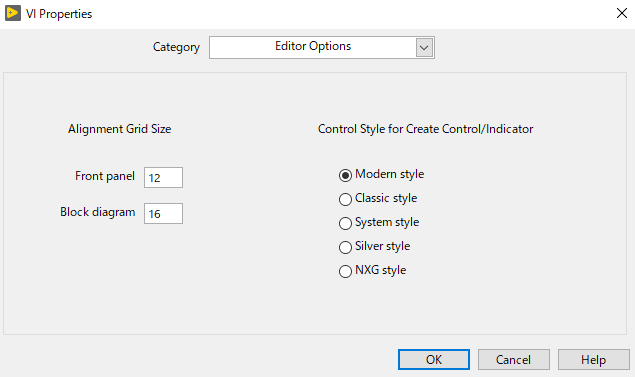

I want to change the grid size of front panel. How can I do that?
  • New VIs
Changing the grid in LV options will apply to new VIs.
Tools>>Options..>>Front Panel>>Front Panel Grid>>Default panel grid size (pixels)
  • Existing VIs
Changing the grid in the VI properties will apply immediatly to existing VI.
File>>VI Properties>>Editor Options>>Alignment Grid Size>>Front panel
