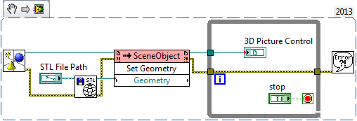

Yes, if you have LabVIEW Full or Professional Development System, you can display 3D models on the front panel using the 3D Picture Control VIs. These methods are not available with LabVIEW Base.
Using a while loop will allow the 3D model to be controlled, such as rotation and zooming.
LabVIEW 8.5 and later example:
Use the Set Drawable method to
LabVIEW 8.4 and earlier example:
Set Geometry is a method that was deprecated after LabVIEW 8.4.

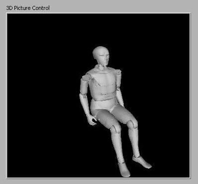

The 3D Picture Control camera viewpoint will be fixed by default. Follow the steps for Configuring a Camera for a 3D Scene to enable you rotate the model within the 3D Picture Control.
This is an example 3D Picture Control displaying a 3D model as shown on the Front Panel of LabVIEW.
