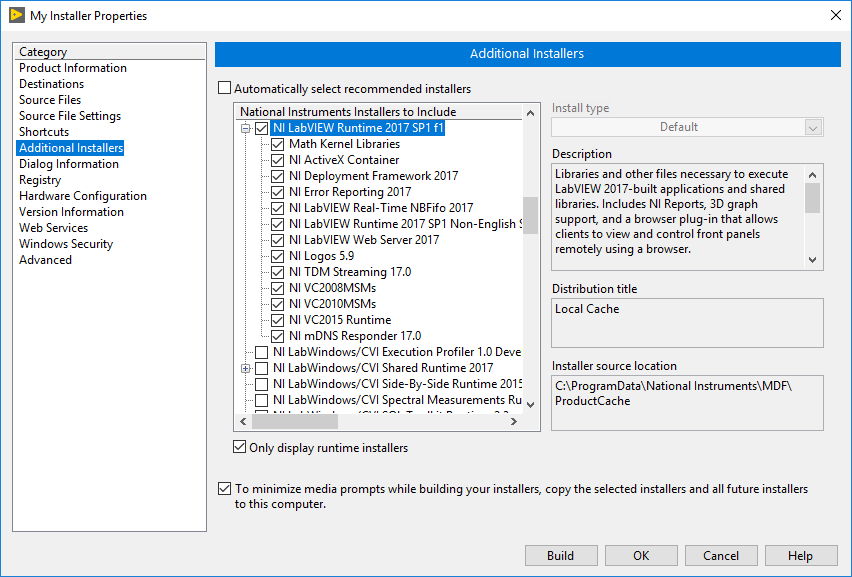

You can select which options of the Run-Time Engine you want to include in your distribution in the Additional Installers category of the Installer's properties dialog box. We recommend including the full LabVIEW Run-Time Engine as it is marked by default.
Unfortunately, it is not possible to make the RTE any smaller than it is. We have broken down the installers for our various software packages as much as possible. For example, if you are creating an installer and select to install only the LabVIEW Run-Time Engine (ie. no other drivers like NI-DAQmx, NI-488.2, etc)
