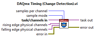

devices and modules that support change detection . Digital change detection can be configured using the DAQmx Timing VI by setting the polymorphic selector to
Change Detection. Under this mode you provide the channels to monitor for change detection. A sample will be taken upon detection of an edge. Each line is monitored individually; a detection on any line will cause a sample to be taken on all channels defined by the task.

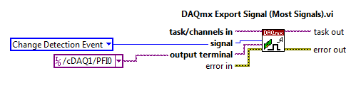

The Change Detection signal is also available to export through the Export Signal VI.

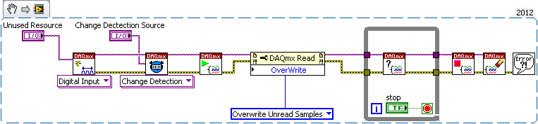

The ChangeDetectionEvent can only be configured by the DAQmx Timing VI as above. If you wish to use the ChangeDetectionEvent line without using the digital edge detection as a sample clock, you must create a "dummy task" that uses Change Detection for its timing. Setup a task on an unused physical channel and configure the timing. Use a DAQmx Read to prevent buffer overflow. Alternatively, configure the DAQmx Read OverWrite property to Overwrite Unread Samples and use the Is Task Complete VI instead of a Read VI. See configuration below.
