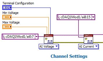

You can create channels of different measurement types in the same task by calling the DAQmx Create Channel VI multiple times. To add current readings to your voltage readings, you can create two channels in series. The following screenshot shows the edit to the example 'Voltage - Continuous Input' (
Help >> Find Examples >> Hardware Input and Output >> DAQmx >> Analog Input) to obtain current readings along with voltage readings:
![](/servlet/rtaImage?eid=ka03q000000t2Qu&feoid=00N3q00000HUsuI&refid=0EM0Z000000W8mi)
You can then display the data normally with the output of DAQmx Read, as shown below:
