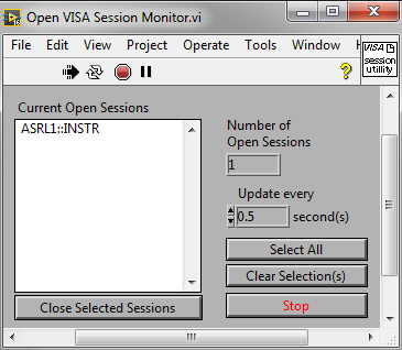

Two VIs exist that list all active VISA sessions in LabVIEW.
  • Open Sessions .vi returns an array of all the active VISA sessions on that machine
  • Open VISA Session Monitor .vi is a standalone VI that allows a user to monitor all open VISA sessions on that machine over time
Both of the above VIs are located in the visa.llb typically stored at the following directory: C:\Program Files\National Instruments\<LabVIEW version>\vi.lib\Utility.
