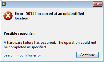

When I wake my computer from a sleep state and I attempt to access my NI-DAQmx hardware in NI MAX or my development environment I receive
Error -50152 "A hardware failure has occurred. The operation could not be completed as specified."
Why does this error occur and how can I resolve the error?
In order to resolve this error it is recommended that you restart the computer. To prevent the error from occurring in the future it is recommended that you do not put your computer into the Sleep power state and that you disable any power options that may automatically put the computer into the Sleep power state after the computer has been idle for a period of time.
