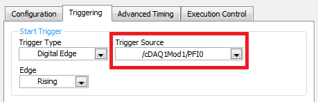

1. External Trigger
To use this method, you must have a CompactDAQ chassis with one or more built-in PFI lines or a parallel digital I/O module. Refer to Digital I/O Considerations for C Series Devices and cDAQ Module Support for Accessing On-board Counters to learn what modules can be used to import external triggers.
You can then take the PFI lines on the digital module to import an external trigger. On your DAQmx step, select the Triggering tab and select Digital Edge for the Trigger Type field. Choose the PFI lines your trigger signal is wired to in the Trigger Source field.
At this point, you should be able to use a digital signal from your digital module to trigger the tasks simultaneously.

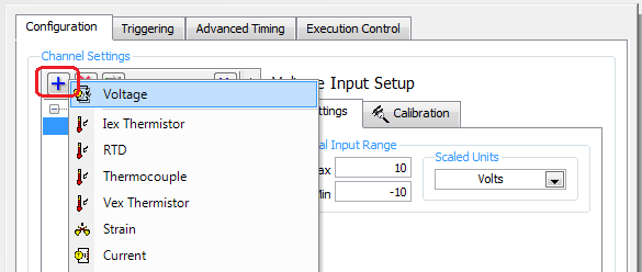

2. Channel Expansion or Multidevice Task
Channel expansion is the easiest method to synchronize and start multiple modules. However, it is limited to modules of the same time (e.g. all modules must be Analog Input) and all the modules will need to acquire or generate at the same sample rate. If you need to synchronize modules of different types or the modules need to acquire or generate data at different rates, refer to the other methods in this document.
If the aforementioned limitations are not a problem, when you add the step to the SignalExpress project, expand the modules you want to synchronize, press the Ctrl key and click on the channels you want to add to the step.
If the step already exists, click the Add New Channels button to add the channels of the other modules.
For more information about Channel Expansion or Multidevice Tasks, refer to Easily Synchronize and Trigger NI-DAQmx with Channel ExpansionChannel Expansion Explained and C Series Multidevice Tasks .
