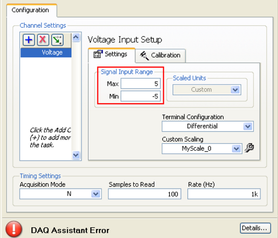

​When I create a DAQmx Custom Scale in NI Measurement & Automation Explorer (MAX) or LabVIEW, I receive the error message below. How can I fix this?

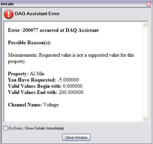

Error -200077 occurred at DAQ Assistant
Possible Reason(s):
Measurements: Requested value is not a supported value for this property.
Property: AI.Min
You Have Requested: -5.000000
Valid Values Begin With: 0.000000
Valid Values End with: 200.000000
Channel Name: Voltage
When the signal input range does not match the scaled values, as in the figure below, error -200077 can occur.

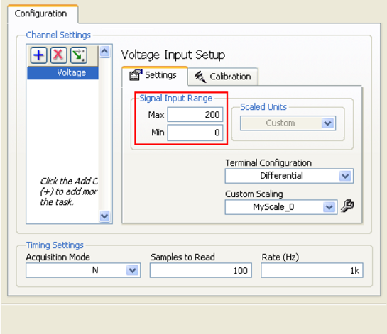

The signal input values of the device are represented with the units as the scaled values. For example, if the scaled values range is 0 to 200V and the pre-scaled value range is -5 to 5 V, then the signal input range must also be 0 to 200V and not +/-5V. In other words, when a custom scale is created, the scaled values must match the signal input value.
In case the error persists after the change of Signal Input Range, reboot the computer.

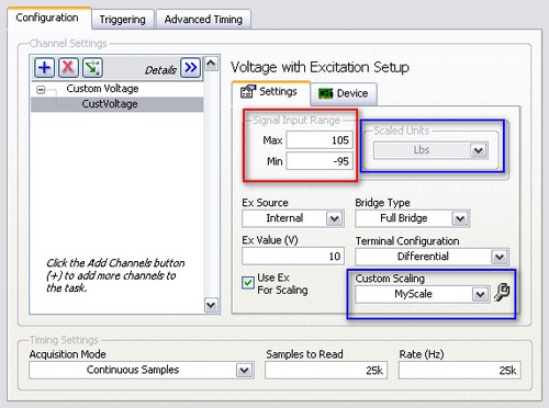

Remember that there will not be a symmetric Signal Input Range anymore, shown below in red, when using an intercept.
Note: Verify the custom scale is applied and the new Scaled Units are displayed correctly, shown above in blue.

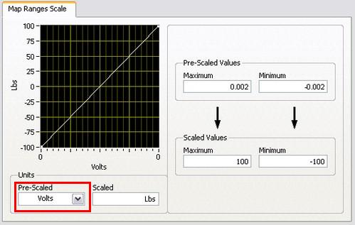

  • Map Ranges Scale
This scale is convenient for directly assigning Pre-Scaled Values to their corresponding Scaled Values, where the maximum and minimum Pre-Scaled Values are +/- the transducer's Rated Output (R.O.) in Volts.
Ex:  A 100 lb tension/compression load cell with a 2 mV/V R.O.
Note: Remember to verify a custom scale is selected and the new units appear as expected in the DAQmx task as shown in blue in the task configuration.
