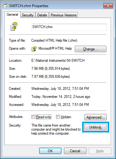

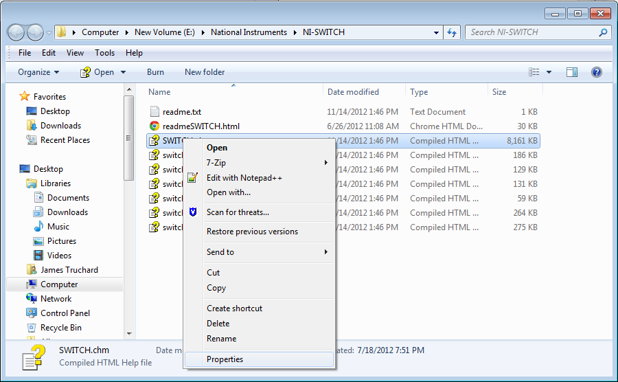

  1. Right-click on the .chm help file in Windows File Explorer and select Properties.
  1. At the bottom of the General Properties pane, click Unblock, then click Apply.
    • If this option is not visible, the file is likely already unblocked, not marked as a downloaded from the internet, or blocked by higher-level security policies. Skip to step 3 instead.
  1. If the Unblock option was not visible in step 2, use the Unblock-File PowerShell command to unblock the file instead.
