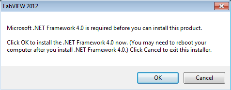

When trying to run an NI installer, I see the following message dialog:
Microsoft .NET Framework 4.0 is required before you can install this product.
Click OK to install the .NET Framework 4.0 now (You may need to reboot your computer after you install .NET Framework 4.0.) Click Cancel to exit this installer.
Why is Microsoft .NET Framework required before installing NI software?
NI software makes use of features of the Microsoft .NET Framework 4.6.2 or earlier, and therefore this framework is needed on a system to use NI software. If the proper .NET Framework is not detected on your system prior to software installation, NI installers will ask you to install the framework before continuing.
Microsoft's policy for software that installs the Microsoft .NET Framework 4.6.2 and earlier states that a reboot may be required before installing any other software. NI installers honor this reboot request.  After rebooting, you can restart the NI installer and installation of your NI software will proceed.
