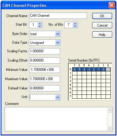

When receiving messages using the Frame API, you receive the data as an array of unsigned 8 bit characters. Since there are up to 8 bytes of information per message, many messages have multiple channels of information. This allows a single CAN frame to have multiple pieces if information. The Channel API will allow you to automatically parse each channel from a message and scale that channel as necessary.
This image of the Frame API shows the 8 bytes of information. There is no indication of which bytes are paired, which order the bytes should go in, or any scaling information. When configuring the CAN channels in MAX, all of this information can be entered to automatically format the data into the format desired by the user.
When using the Channel API in LabVIEW, you need to specify that you would like to read the value of Data3 and the read will automatically return the value of the last 12 bits scaled and offset.
