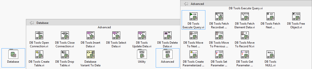

With the Database Connectivity Toolset I can create a table, insert data, and select data from a table. How can I execute advanced SQL statements with the database connectivity toolset?
Advanced statements such as update, which changes data, and delete can be executed inside of LabVIEW by sending SQL statements to the database. This can be accomplished by using the DB Tools Execute Query VI which can be found in the Functions»Database»Advanced palettes of the Functions Pallette. This VI will allow the user to execute any SQL statement including the delete and update statements.
The Database Connectivity Toolset makes it easy to access a database by executing many of the SQL commands for you without requiring you to know SQL.
For example, you can easily select data from a database by using the SELECT command. By either entering SELECT column_name(s) FROM table_name or Select * FROM TestTable  you can select data from a database.  This returns a cluster of two references. One of the references returned is the ADODB._Recordset. After you filter out the recordset fields with a Fields Property Node,  use a Fields Invoke node to get references to the items stored in the Fields of your databases.
For instance, the information you could be searching for might be the names of column headers for the SQL Database. If that were the case, you could index through the fields retrieving all of the Field references and then get the name of each reference. For more information about how to use this particular advanced SQL statement with labVIEW, follow the Community Example: Get Column Headers from SQL Query with Database Connectivity Toolkit  .
