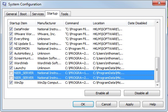

For Windows 7 systems:
  1. Go to Start»Run
  2. Type msconfig and click OK
  3. In the System Configuration Utility go to the Startup tab
  4. Disable the Entry NIER_SERVER.  There will be two entries if you have both LabVIEW 32-bit and LabVIEW 64-bit installed.
