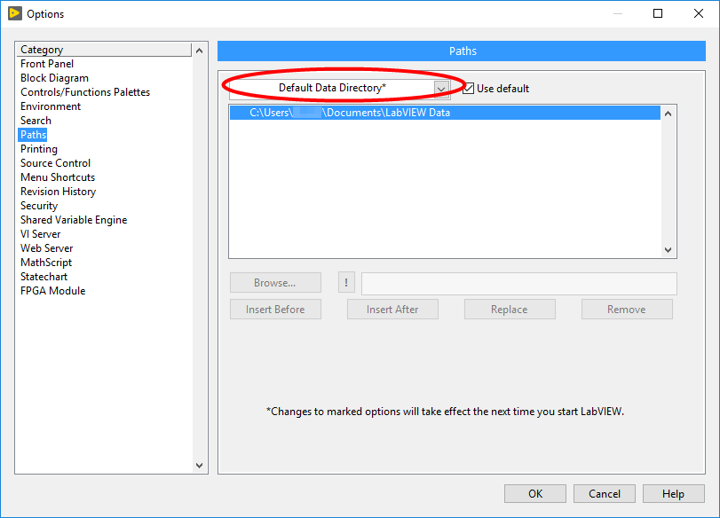

LabVIEW error log files are stored in LabVIEW's Default Data Directory. You can view or edit this location from the menu Tools » Options » Paths. Then select Default Data Directory in the drop-down menu. At this point, your window will resemble the screenshot below:
The default LabVIEW data directory is: C:\Users\<My User>\Documents\LabVIEW Data, where <My User> refers to your user account's folder.
