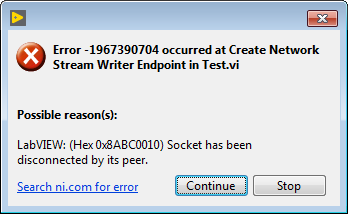

When calling Create Network Stream Writer Endpoint, I get following error:
Error -1967390704: Socket has been disconnected by its peer.
If I run the VI multiple times, I sometimes also get following error:
Error -314350: Another application is already streaming data to an endpoint in the context you specified. If you specified a context name in the reader name or writer name terminal of the endpoint, you must specify an unused context name. If you did not specify a context name, you must specify an unused context name by entering an endpoint URL in the reader name or writer name terminal.
