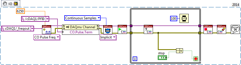

To create a frequency output signal without the use of a counter you can perform the following steps to program this signal in NI-DAQmx:
  1. Configure a counter output task for frequency pulse generation, using the DAQmx Create Channel VI.
  2. Set the counter channel name input as <NI-DAQmx Device Name>/freqout and set the frequency input as the desired value of the divided down timebase. (To be able to view this channel, right-click on the control or constant and select I/O Name Filtering. In the dialog box that appears, place a checkmark next to Internal Channels and select OK.)
  3. For an M or X Series device, the signal may be routed to any PFI or RTSI line by using the CO.Pulse.Term property node (DAQmx Channel Property»Counter Output»Pulse»Output Terminal).
  4. For an E Series device, the sample mode must be set to Continuous Samples using the SampQuant.SampMode property node (DAQmx Timing Property»Sample Quantity»Sample Mode).
  5. The task can be started and stopped the same way a counter output task would, using the DAQmx Start Task and DAQmx Stop Task VIs, respectively.
