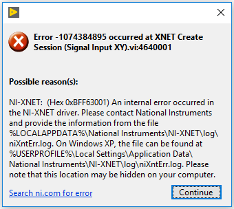

  • My NI-XNET session in LabVIEW is generating error -1074384895. How can I fix this?
  • When I try to create an NI-XNET session I get either Error -1074384758 or Error -1074384895: NI-XNET: (Hex 0xBFF63001) An internal error occurred in the NI-XNET driver.  Why is this and how can I correct this issue?

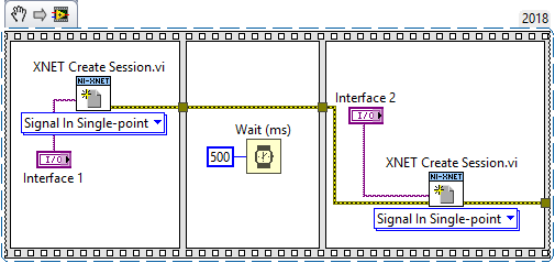

  • If you are creating multiple XNET sessions, add a delay between the XNET Create Session VIs like in the illustration below.
