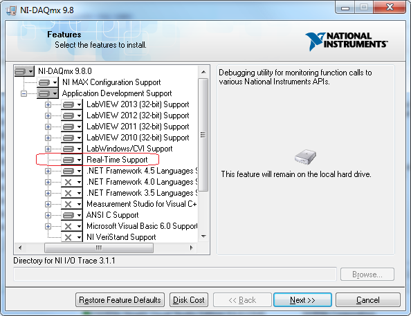

1. Close NI MAX, and any other National Instruments Software that you have running.
2. Download and install the NI-DAQmx Driver. When prompted to select which features to install, make sure you select Real-Time Support.
3. Reboot your computer after the installer finishes.

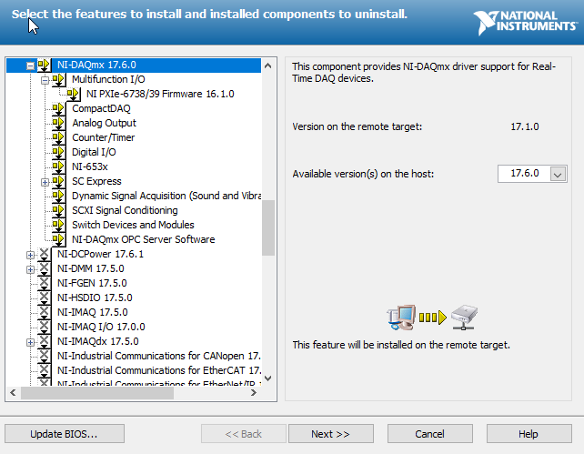

4. Open NI MAX, locate your target and expand it using the arrow located on the left of your device.
5. Right click on Software and select Add/Remove Software.
6. Select Custom Software Installation (if given suggestions of software versions to install), and look for the NI-DAQmx driver.
When installing NI-DAQmx on the development/host PC, make sure to install Real-Time support for LabVIEW and/or LabWindows™/CVI. This will install Real-Time (RT) images to the host machine which can then be installed on the RT device using the Real-Time Software Wizard in MAX.
