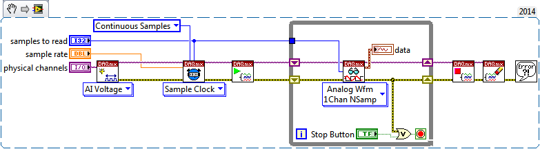

Solution 2: Configure DAQmx to Acquire Continuously
If a while loop is needed, another solution is to configure the task to acquire Continuous Samples instead of Finite Samples. When this option is selected, the DAQ device will continue acquiring data until the task is explicitly stopped.
