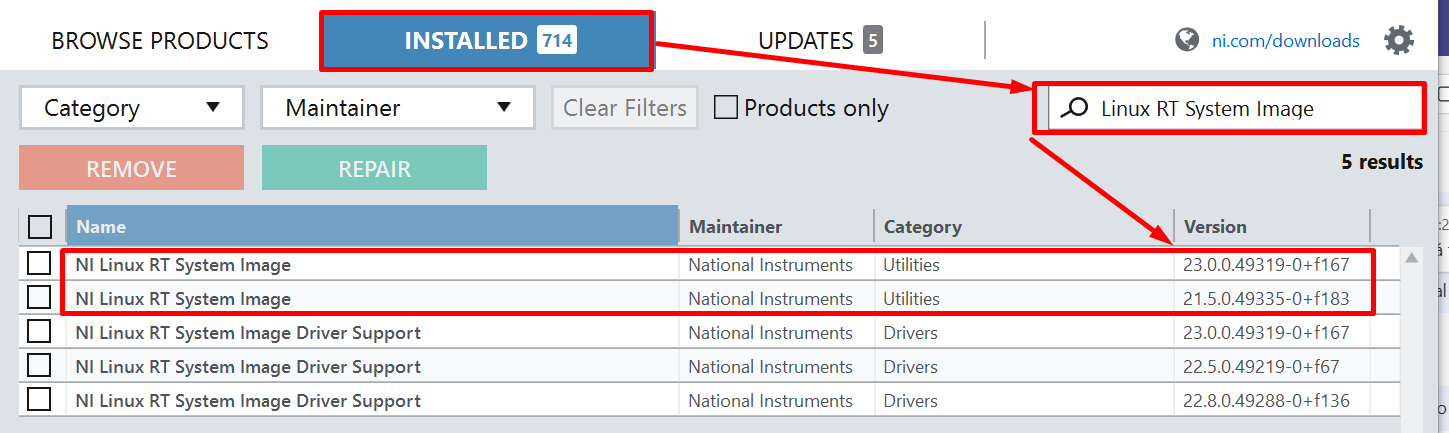

  • Verify you have a Linux RT Image installed in your PC, you can check the following link to download the OS Image you need: NI Linux RT System Image

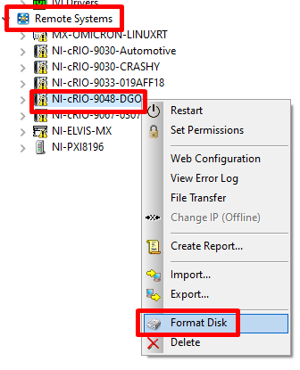

    • (Method 1: NI MAX Formatting). In NI MAX, go to Remote Systems, identify your RT device and right click on it, then choose the format disk option
  • If after formatting the target the issue is still present, there should be a software corruption in the software installed on the host computer. Remove and reinstall all the software required for your cRIO using NI Package Manager.
