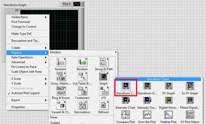

To switch between a Waveform Graph and a Waveform Chart, you can right-click on the graph or chart, select Replace, and then select the item of choice from the Controls Palette. The following screenshot shows how to replace a Waveform Graph with a Waveform Chart:
