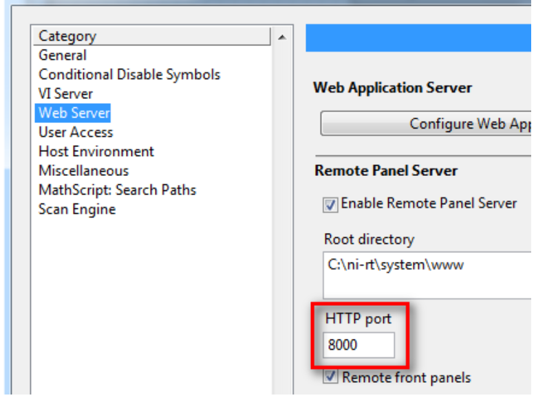

  • You need to specify the remote panel port. The remote panel HTTP Port is specified in the Remote Panel Server section of the Web Server category in the Properties of a Target as shown below.
This port number should be included after the IP address of the target. So if port 8000 (the default) is chosen as the HTTP Port, then the address of the Remote Panel should be:
http://<IP Address>:8000/<Name of HTML File>
