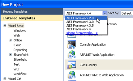

Similar to previous versions of Visual Studio, Visual Studio 2010 allows the user to target a specific version of the .NET Framework to build the assembly against. Thus, you can still use Visual Studio 2010 to build your assemblies so long as you target them for .NET Framework 2.0, 3.0 or 3.5. For instructions on how to change the target framework version, see the How to: Target a Specific .NET Framework Version or Profile MSDN article.
If you open an old .NET project in Visual Studio 2010, the conversion process will automatically configure the converted project to maintain the original target framework version of the old project. For example, if you open a Visual Studio 2005 solution/project in Visual Studio 2010, the converted project will specify .NET Framework 2.0 in the Target framework combo box.
For new .NET projects,  you can specify the target framework version at the time of project creation as shown below:
