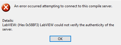

  • Error 363507: An error occurred attempting to connect to this compile server.
    Details: LabVIEW: (Hex 0x58BF3) LabVIEW could not verify the authenticity of the server.

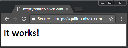

  • Navigate to https://galileo.niwsc.com/ in your web browser and make sure you can see a white page with the words "It works!" on the page. This tests the most basic connection to the server farm.
