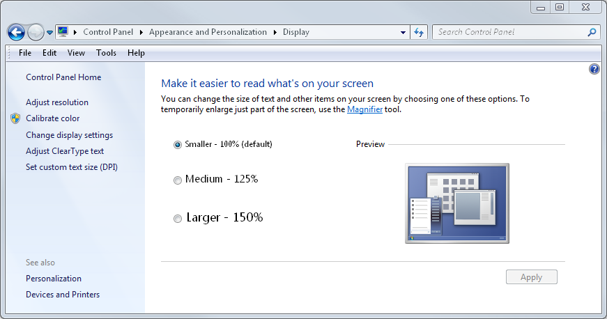

If using Windows 7, the font size can be changed by going to the Control Panel and navigating to Appearance and Personalization»Display where you can select the desired font size.

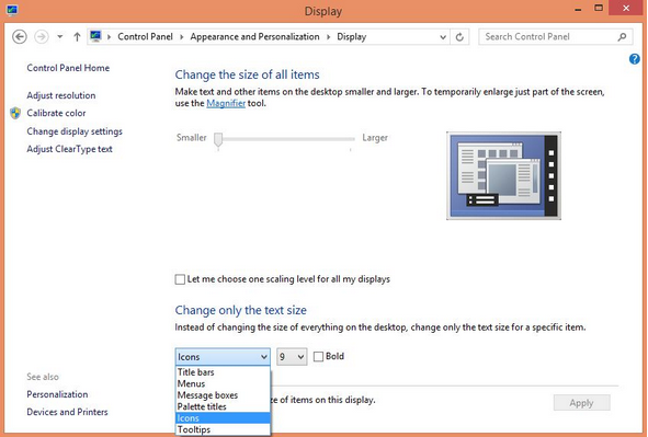

If using Windows 8, to change the font size navigate to Control Panel»Appearance and Personalization»Display.  The display window will give you customization options.  Be sure to click the Apply button after making the necessary changes

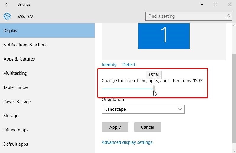

If using Windows 10, to change the font size go to your Desktop, right-click your mouse and go to Display Settings.  From this panel, you can change the size of the font with the slider.

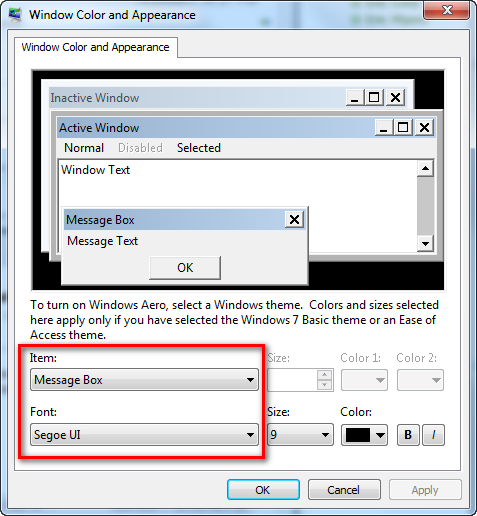

To check this in Windows 7, right click on the desktop and choose personalize. Then select the window color link at the bottom of the screen and then click on the advanced appearance settings link. Select Message Box in the item drop down menu. The font will display below.

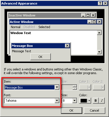

To check the message box font in Windows XP, right click on the desktop and choose properties. Then select the appearance tab at the top. Click the advanced button. Select Message Box in the item drop down menu. The font will display below.
To check the message box font in Windows 8, navigate to the Display section referred to in the instructions for setting the font size, and select the Message Box category of the drop-down menu.
