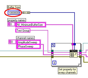

The last option is to use a buffer to store a certain amount of data before being written to the TDMS file.  If you are only writing one point of data per TDMS Write in your code then you can specify a minimum buffer size that must be achieved before anything will get written to the TDMS file. This will decrease the number of headers being written, which will also speed up performance. To accomplish this, use the TDMS Set Properties.vi to set the NI_MinimumBufferSize to a desired value for every channel being written to the TDMS file. You can find the steps to set the minimum buffer size on the following LabVIEW Help page: File Buffering with TDMS Files.
