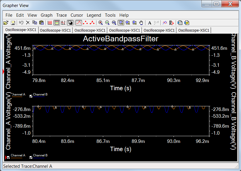

If you would like to have more than one graph inside the same tab in Grapher View like depicted in Figure 1 below, you can do the following steps.
Figure 1

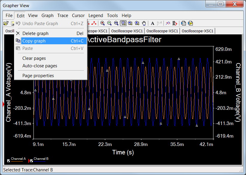

  1. Click the appropriate tab of the graph you want to copy, got menu Edit » Copy Graph.

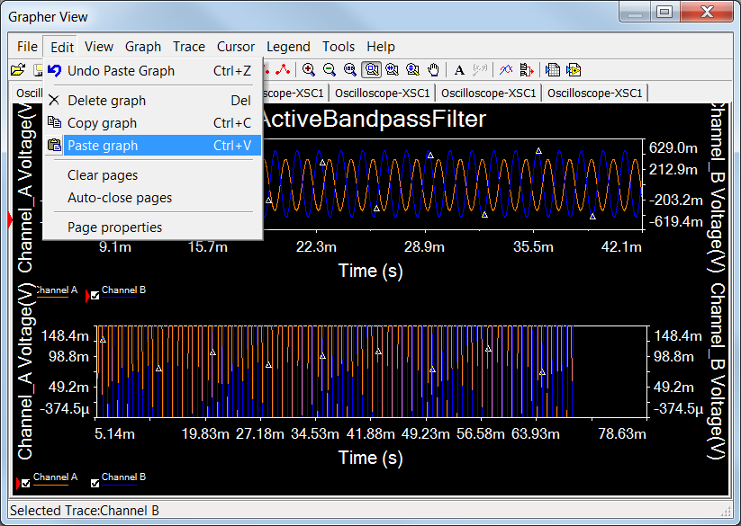

  1. Go to the next tab, select Edit » Paste Graph.

  1. Your Grapher View should now look like Figure 1, showing two graphs in one tab.
Note: You will be able to zoom into each graph separately.
