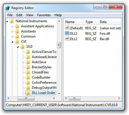

This crash occurs because of the order in which the LabWindows/CVI linker writes imported function information to the imports section of the final executable. LabWindows/CVI 2010 and later exposes a method for changing this order. To fix the crash mentioned previously, LabWindows/CVI must write the imported function information for mixed-mode DLLs before all other DLLs. Complete the following steps to enforce the order in which LabWindows/CVI writes this information:
  1. Close all instances of LabWindows/CVI.
  2. Navigate to the registry key HKCU\Software\National Instruments\CVI\<version>.
  3. Create a new key named DLL Load Order.
  4. Create new string values for the mixed-mode DLLs to which you want to link. Use DLLx, where x is a numeric representation for the load order, as the Name value and the DLL name as the Data value. For example, add the following, depicted registry entries to force the information for mixed-mode DLLs Foo and Bar to be written first and second:
  5. Open LabWindows/CVI and rebuild the application that depends on the mixed-mode DLLs you listed in the registry.
