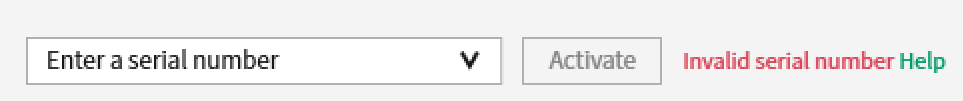

  • After installing Multisim I am not able to activate the product. I always get an activation error saying that my serial number or activation code does not match an installed product.
  • I have received a serial number to activate my Multisim software from my Software administrator. However, when I try to activate my software, I get an activation error indicating: Invalid serial number or Invalid activation code.
There are a couple of common reasons that could cause this behavior, one is adding spaces to the serial or activation code, and the second is that your serial number or activation code are meant to activate a different Multisim edition or version. To solve this, please check the next steps:
  1. When you copy-paste a serial number you might be copying it with additional spaces at the end, if you notice there are additional spaces added, please remove them before clicking Activate, you may also prevent this by manually entering the serial number or activation code. Check if this solves your activation issue, if not check step 2.

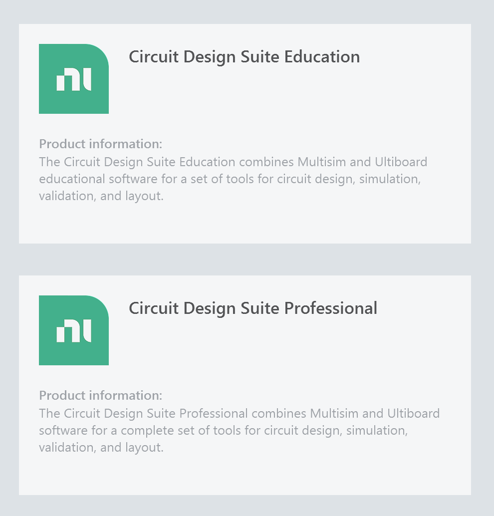

  2. Make sure you installed the Multisim edition that your serial number can activate. There are two different installers for the Circuit Design Suite editions (which contains Multisim and Ultiboard) available. If you don't have the appropriate edition, please install the software using the corresponding installer:
    • NI Circuit Design Suite Education Edition - and Student Edition
    • NI Circuit Design Suite Power Professional- Full and Base Editions

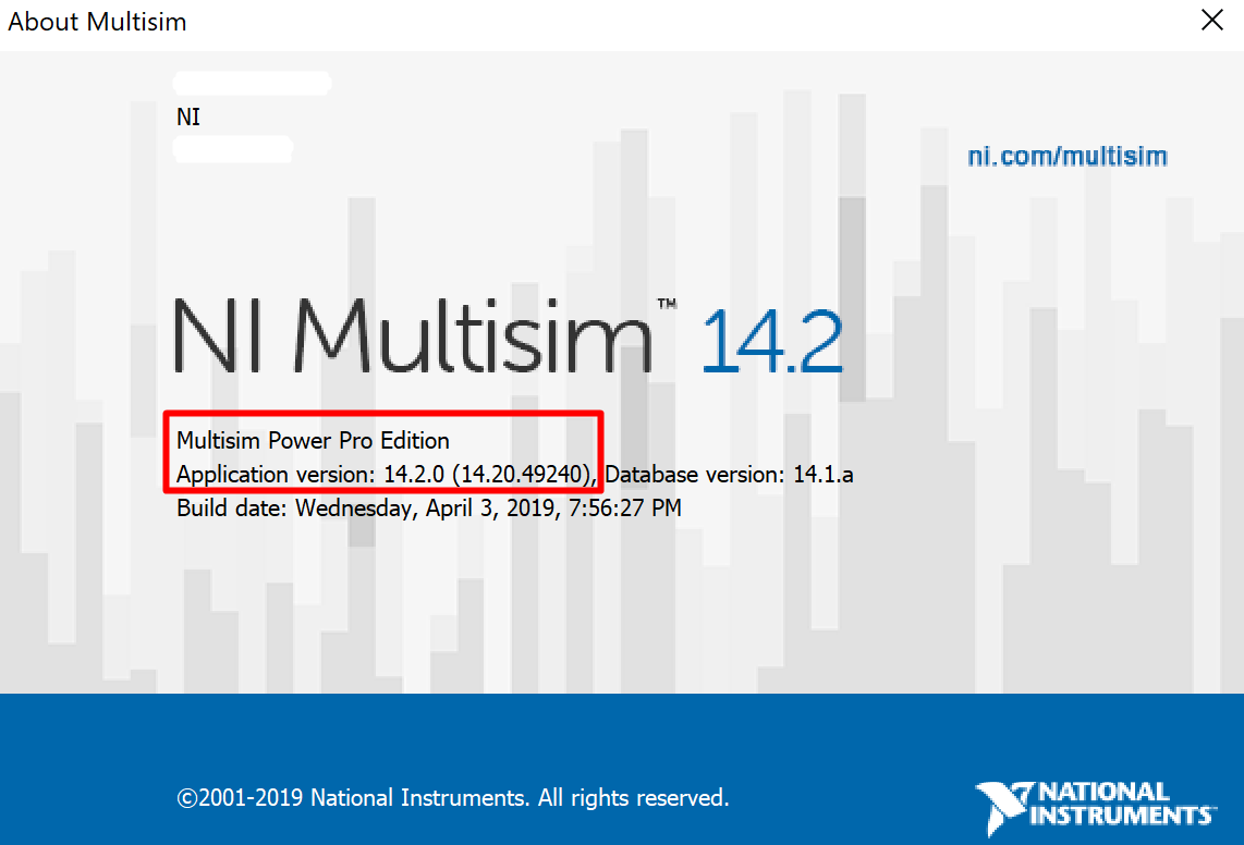

    You can verify your exact installed version in NI License Manager or in Multisim by going to Help>>About Multisim. After installing the appropriate Multisim edition and version please try your activation again, making sure you do not add any additional spaces to the serial number or activation code in the Activation Wizard.

  • If you are installing the software through NI Package Manager, the editions are two different product pages:
