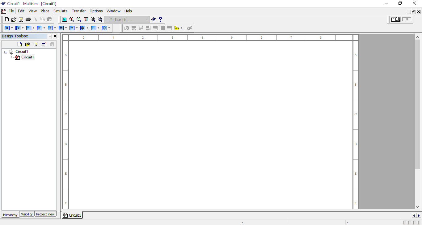

Many of the toolbars that I commonly use in Multisim are grayed out, including the component toolbar.
I am unable to place components through the toolbar. How can this be fixed?
The options available in Global Restrictions menu allows you to enable or disable toolbars. If your toolbars are grayed out, you can simply return the toolbar options to their default settings by following these steps:
1. Select Options ยป Global Restrictions
2. Enter the password.  The default passwords are case sensitive and are as follows:
             a. Multisim 6 (2001): testbench
             b. Multisim 7: S7lock
             c. Multisim 8,9,10,11,12: Rodney
3. Under the General tab, un-check all the checked boxes.
4. Click the OK button to save the new settings and exit the Global Restrictions dialog box.
    All toolbars will now return to their default settings in Multisim environment.
