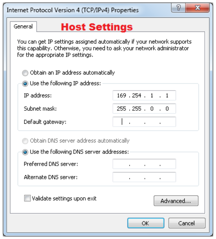

When making a direct connection to a LabVIEW Real-Time controller using an Ethernet cable, you must first disable DHCP on your Host PC. If you do not disable DHCP, you may find that some communication with the controller is not working properly. For example, the system may fail to appear in Measurement & Automation Explorer (MAX), or the system may fail to install software on the system. Below are instructions for various operating systems.

  6. On the General tab, select Use the following IP Address.
  7. At this point, you can enter your own IP Address and Subnet Mask. A typical set of settings for a standalone computer are an IP Address of 169.254.1.1 and subnet mask 255.255.0.0. Press the OK button and exit the Network control panel.

Notes: Make sure your static IP address assignment takes effect by going to Start»Run, then typing cmd. In the window that opens, type ipconfig and verify that the IP address appears as assigned. If it is inconsistent with what you've assigned (for example 0.0.0.0), there may be IT restrictions limiting which IP addresses you can assign yourself. In that case, contact your network administrator.

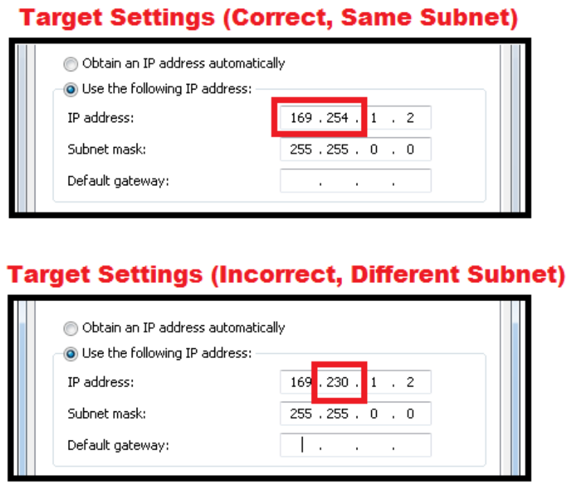

If the RT controller already has a static IP address, make sure that the controller's settings are consistent with the IP settings on your host computer. The host and RT controller will need unique IP addresses that are on the same subnet.
For the example above, an IP address of 169.254.1.2 and a subnet mask of 255.255.0.0 would be on the same subnet.  If the controller has not been configured, you could also use the Suggest Values button in MAX to select a valid IP address and subnet mask now that the host computer has a static IP address.

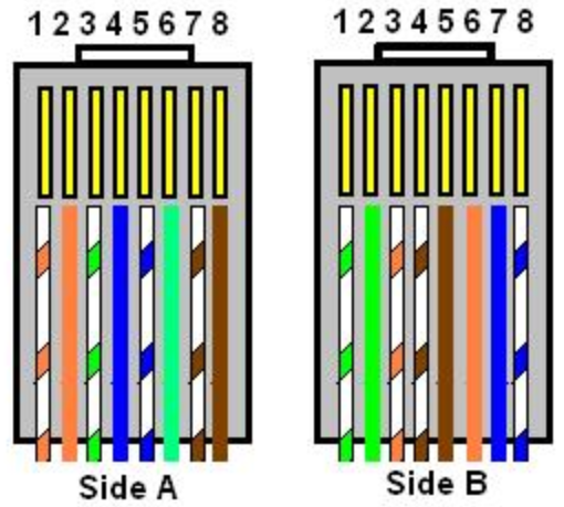

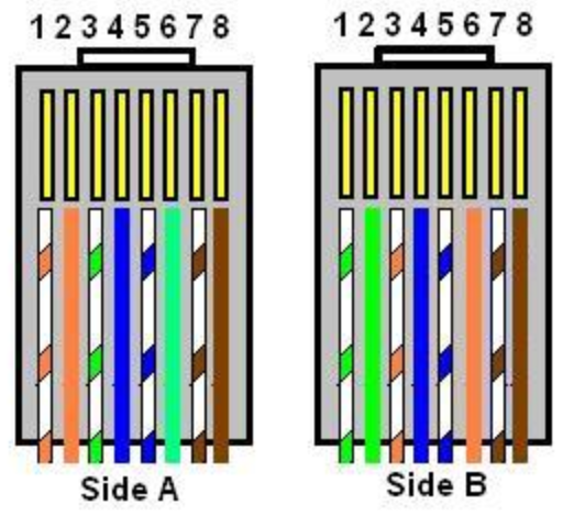

Most Ethernet cables are straight (patch) cables, not crossover cables. To determine the type of cable you have, look at the 8 colored wires that are visible through the clear-plastic connectors on both ends of the cable. If the green and orange wire position is swapped between one end and the other as seen in the images (top: 10baseT/100baseTX crossover cable, bottom: below: 10baseT/100baseTX/1000TX/T4 Crossover Cable) below, then the cable is a crossover cable; however, if the green and orange wires are in the same relative positions on both ends of the cable, then it is a patch cable. The 1000baseTX/T4 (Gigabit) standard specifies that crossover cables have all wires swapped in position.
