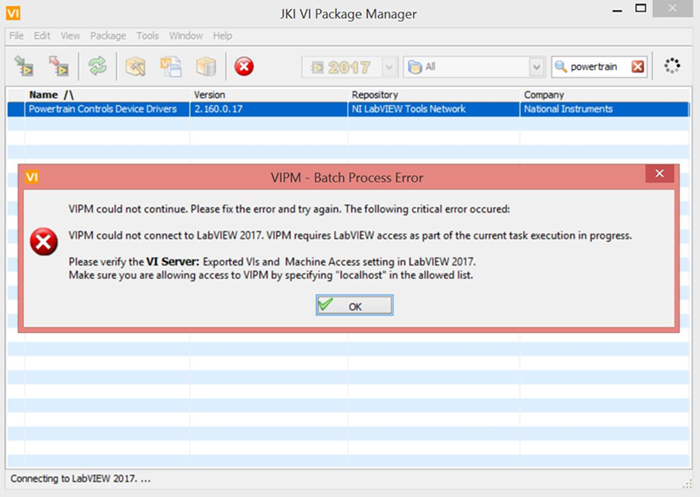

當我嘗試在LabVIEW中安裝VI Package文件或嘗試從VI Package Manager安裝LabVIEW Add-on時,VI Package Manager無法連接到LabVIEW。這會使我無法安裝文件,因為出現了等待畫面,並且經過一段時間後,我看到以下錯誤之一:

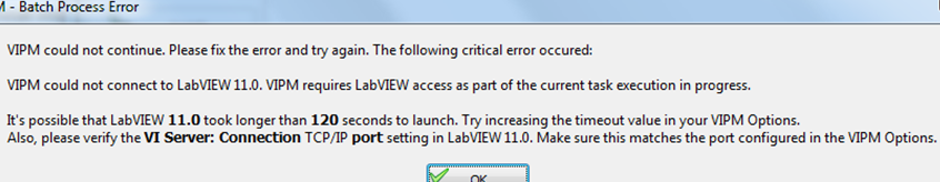

VIPM could not continue. Please fix the error and try again. The following critical error occured:
VIPM could not connect to LabVIEW XX.X. VIPM requires LabVIEW access as part of the current task execution in progress.
It's possible that LabVIEW XX.X took longer than 120 seconds to launch. Try increasing the timeout value in your VIPM Options. Also, please verify the VI Server: Connection TCP/IP port setting in LabVIEW XX.X. Make sure this matches the port configured in the VIPM Options.

VIPM could not connect to LabVIEW 20xx. VIPM requires LabVIEW access as part of the current task execution in progress.
Please verify the VI Server: Exported VIs and Machine Access setting in LabVIEW 20xx. Make sure you are allowing access to VIPM by specifying "localhost" in the allowed list.

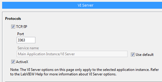

完成以下步驟,以在LabVIEW中配置VI Server連接。
  1. 打開LabVIEW,然後點擊Tools » Options,以打開Options對話框。
  2. 從左側的Category中選擇VI Server
  3. 在“Protocols”部分的“ TCP / IP”複選框中放置一個複選標記。
  4. 記住並紀錄當下的Port 號碼。預設為3363。您可以自行修改,但LabVIEW和VI Package Manager都必須設置為相同的Port。如果您的電腦上安裝了多個LabVIEW版本,則每個Port會有不同的顯示。以下範例顯示了完整的協議部分:

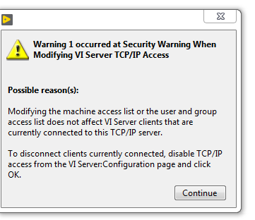

注意嘗試從“Machine Access”列表中刪除內容時,您可能會收到“Security Warning” ,如下所示:
Warning 1 occured at Security Warning When Modifying VI Server TCP/IP Access
Possible reason(s):
Modifying the machine access list or the user and group access list does not affect VI Server clients that are currently connected to this TCP/IP server.
To disconnect clients currently connected, disable TCP/IP access from the VI Server:Configuration page and click OK.

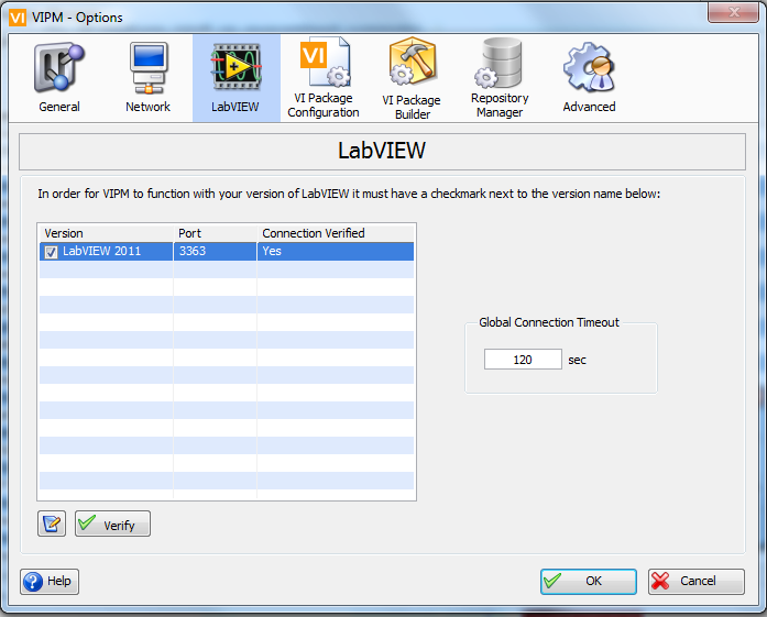

完成以下步驟,以在VI Package Manager中配置VI Server連接。
  1. 打開VI Package Manager,然後Tools » Options以啟動Options對話框。
  2. 點擊LabVIEW
  3. 確認Port與先前配置的LabVIEW VI Server Port匹配。如果需要,點擊 edit icon 以更改Port。
  4. 點擊Verify按鈕。
有關完整的LabVIEW配置示例,請參見以下對話框:
VI Package Manager將重新啟動LabVIEW。 LabVIEW啟動後,VI Package Manger將建立連接,您將能夠安裝軟體。
