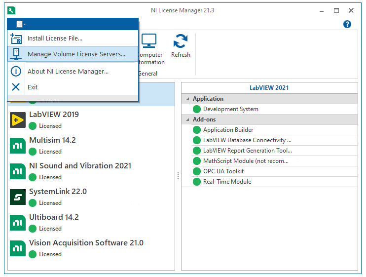

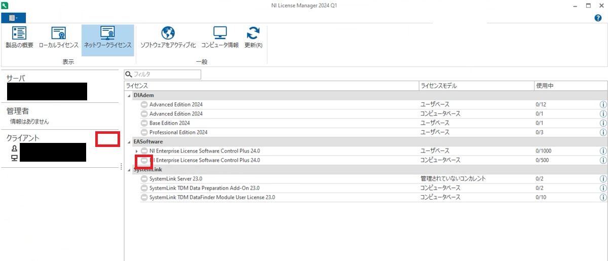

Make sure you are connecting to the Volume License Server
Ensure you are connected to the Volume License Server for your organization. This can be checked in NI License Manager under "Network Licenses" and looking under the server name. If no server name appears, you can add a server by going to the blue book tab and selecting "Manage Volume License Servers," where you can add the name of one.
You can verify the name you are entering matches the Volume License Server name by talking to your software admin.
