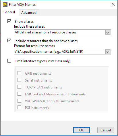

  2. Make sure the I/O Name Filtering settings on the VISA resource control are set so all instruments can appear in the drop-down:
  • Right-click on the VISA resource control and select I/O Name Filtering.
  • Make sure the settings match the following:
  • Select OK and refresh the VISA resource control drop down.
