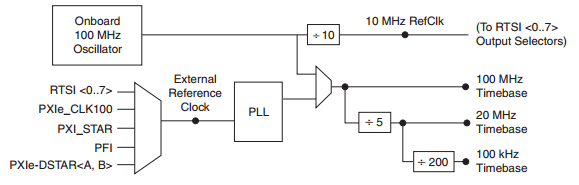

A good visual example of this is shown in the following figure 1 from the X Series manual.
Figure 1. X Series Timing Sources

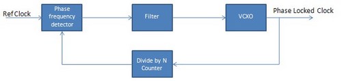

This block diagram shows how the PLL is used to derive the rest of the timing signals in the X Series DAQ devices. Figure 2 shows a block diagram of the PLL that is used on the M Series DAQ devices.
Figure 2. PLL Block Diagram
