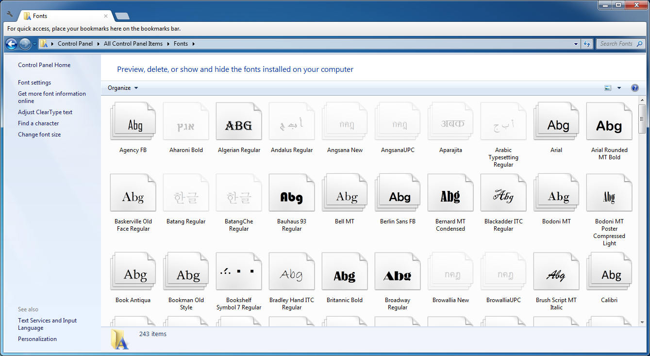

LabVIEW populates the font ring with the fonts that Windows has registered or installed on the system.
To modify which fonts appear in LabVIEW :
  1. Obtain/download a font file (typically .ttf, .otf, or .fon format)
  2. Double-click the font file and select Install for all users.
  3. Open the Control Panel in Windows and navigate to Appearance and PersonalizationยปFonts
  1. The new font will appear in this list, and the list of available fonts will be updated accordingly in LabVIEW without having to relaunch LabVIEW
  2. You can remove fonts from LabVIEW by removing them from the Fonts window (highlight the font you want to remove and press Delete)
