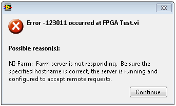

I have installed the LabVIEW FPGA Module and am receiving one of the following error messages upon compilation of my FPGA VI:
  • An error occurred attempting to connect to this compile server
  • Error -123002 - NI-Farm: No worker has registered the given capability name.
  • Error -123011 - NI-Farm: Farm server is not responding. Be sure the specified hostname is correct, the server is running and configured to accept remote requests.
How can I fix this error and successfully compile my code?
