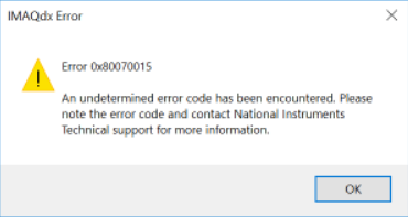

  • I cannot interact with my USB3 Vision compliant camera in NI MAX without getting Error 0x80070015.  The same camera works without issue on my Windows 7 computer.

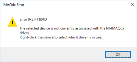

  • The USB camera was operated with a third party driver. When I switch to NI-IMAQdx and trying to use it, it displays VAS Error 0xBFFF801D and the camera does not recognize it.
