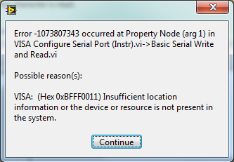

我嘗試在 LabVIEW 中進行 VISA Serial 讀/寫,但是當我嘗試運行程式時,間歇性地收到錯誤 -1073807343:
Error -1073807343 occurred at Property Node (arg1) in VISA Configure Serial Port (Instr).vi->Basic Serial Write and Read. vi
Possible reason(s):
VISA: (Hex0xBFFF0011) Insufficient location information or the device or resource is not present in the system.
