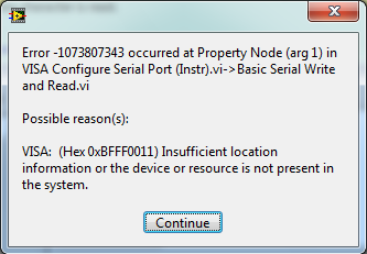

I am trying to do a VISA Serial Read/Write in LabVIEW or LabWindows/CVI, but when I try to run my code I intermittently receive the following error:
Error -1073807343 occurred at Property Node (arg1) in VISA Configure Serial Port (Instr).vi->Basic Serial Write and Read. vi Possible reason(s): VISA: (Hex0xBFFF0011) Insufficient location information or the device or resource is not present in the system.
This error happens when the computer cannot communicate correctly with the device it is sending commands to. Follow these recommended steps to troubleshoot this error:
