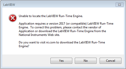

  • I built an application using LabVIEW. When deploying the executable to another computer, I receive an error similar to the error shown below.
  • I installed the LabVIEW Run-Time Engine from the NI website. However, I still get an error asking for the LabVIEW Run-Time Engine when I run my Application.
  • I cannot find LabVIEW Run-Time Engine on my computer.
  • I am using a third-party program and it gives me an error that it cannot locate the LabVIEW Run-Time Engine.
Unable to locate the LabVIEW Run-Time Engine.
This error occurs because the target PC does not have the proper LabVIEW Run-Time Engine (RTE) compatible with the executable. Follow the next guidelines to determine the proper LabVIEW RTE you require.

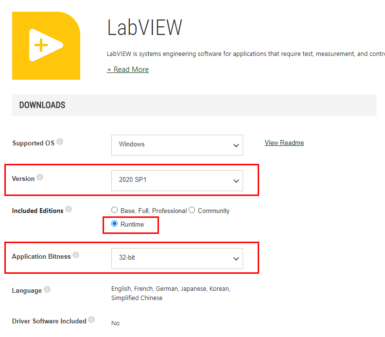

    • Download the correct RTE version onto the deployment computer by going to the LabVIEW Run-Time Download page. You can also download the RTE as follows:
      1. Navigate to the LabVIEW Download page
      2. Under Included Editions select Runtime
      3. Select the Version and Application Bitness that match the application's development
      4. Press Download
