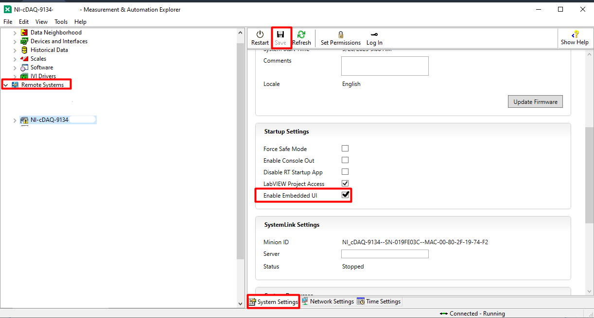

  • Launch NI MAX, navigate to Remote Systems and select your controller from the list. In the Startup Settings section of the System Settings tab, verify that the Enable Embedded UI checkbox has a checkmark. If it does not, place a checkmark, click Save, and then Yes when prompted to restart the target.
