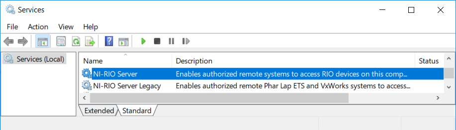

1.  The NI-RIO Server is not set to start automatically on system startup and must be started manually or set by a user to start automatically. The NI-RIO Server can be accessed in Windows XP and later by going to the Start Menu, and then navigating to Control Panel » Administrative Tools » Services.
2.  In the Services window that opens, locate NI-RIO Server in the list, as shown below:

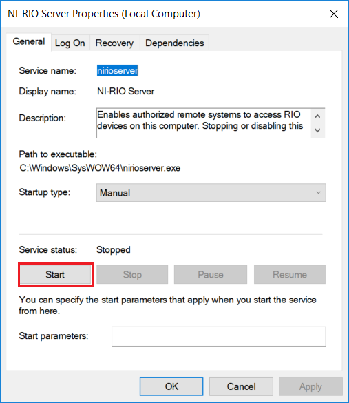

3.  Next, right-click on the NI-RIO Server and select Properties. In the window that opens, click the Start button to start the RIO Server, as shown below:
4. The RIO Server can also be set to run automatically at startup, by changing the Startup type to be Automatic, as shown below:

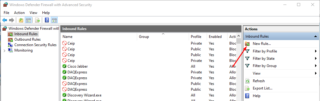

Some systems also require that the user creates firewall rules to allow the NI-RIO Server to connect to the network. To do this, follow these other steps:
- Go to the Windows Start Menu, and search for Windows Defender Firewall with Advanced Security.
 - Once you open the program, go to Inbound Rules and click New Rule...
- Select the Program rule type and click Next.
 - Select the option This program path and enter the following path C:\Windows\SysWOW64\nirioserver.exe. Click Next.
 - Select the option Allow the connection. Click Next.
 - Select the type of networks you want to apply this rule. Make sure to select the option that applies to your type of network.
 - Enter a Name and a Description (optional) for your rule.
 - Repeat steps 2 to 7 but now under the Outbound Rules tab.
