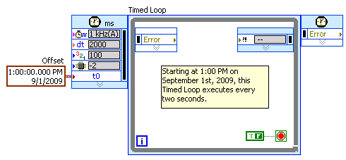

LabVIEW 2009 features the ability to use absolute time timing sources to synchronize the start of timed structures running on one or more distributed computing devices connected over Ethernet. For more information on using absolute timing sources follow the LabVIEW 2018 help link below.
