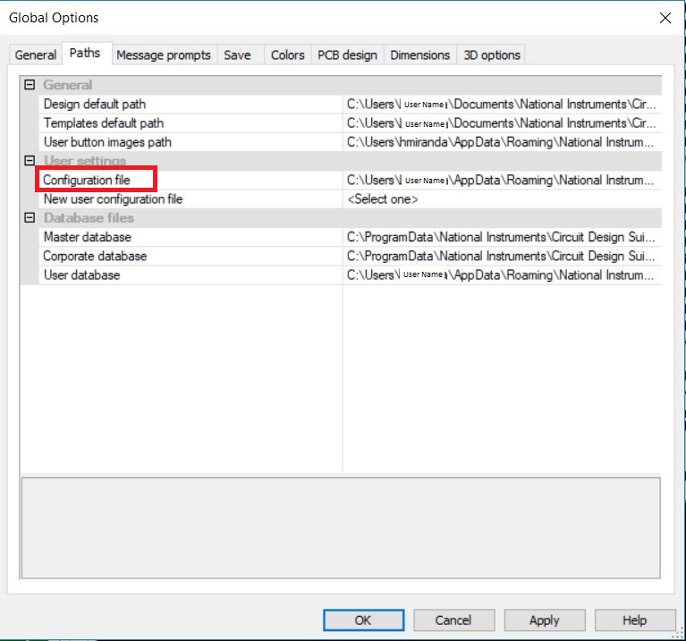

To find the file you are looking for in Multisim, select Options»Global Preferences. The file path next to Configuration File in the Global Preferences window is the path you are looking for.
![](/servlet/rtaImage?eid=ka00Z000000kEOx&feoid=00N0Z00000HEWRt&refid=0EM0Z000000pfGo)
Delete this file and relaunch Multisim or Ultiboard. Your User Interface should now be the original.
