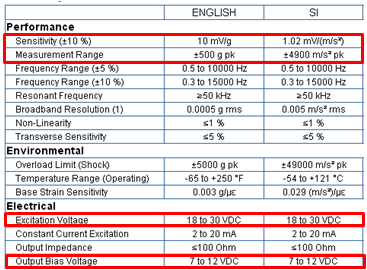

Excitation Voltage is the voltage level required by a sensor.  This is applied at a constant current.  The total voltage difference across an IEPE sensor’s terminals is the sum of output bias voltage and the output signal. As an example, here is a specification excerpt for PCB accelerometer model 352C03:
The excitation needed for this sensor is dictated by the following:
Excitation Maximum = [Highest Measurement Range Value] * Sensitivity + Maximum Bias Voltage
Excitation Minimum = [Lowest Measurement Range Value] * Sensitivity + Minimum Bias Voltage
Thus:
Excitation Maximum = [500g pk] * 10mV/g + 12V = 17 V and
Excitation Minimum =  [-500g pk] * 10mV/g + 7V = 2 V
Based on the Excitation Maximum and Minimum values we calculated, we need a module that has a compliance voltage maximum of 17 V and that the range includes at least 2 V.

Using requirements we calculated earlier, 2V and 17V, and the datasheet above, we can determine that the PCB accelerometer model 352C03 would be compatible with the PXI-4461/4462 since both of those values are within the Compliance Voltage range.
