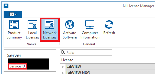

Connected to a License Server
  • Open NI License Manager >> Network Licenses, under the server information, you will find your Service ID.

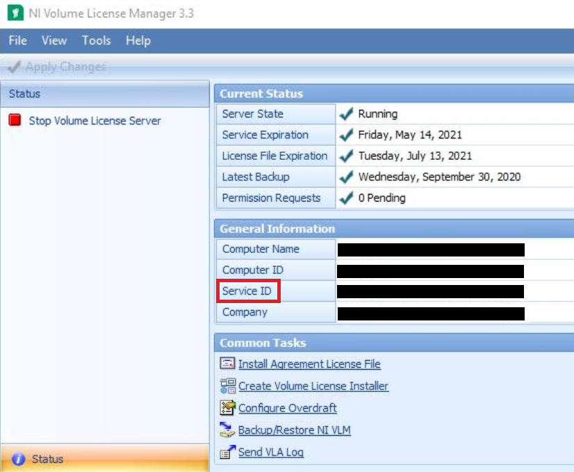

If neither of the above situations apply, please contact your software administrator.
  • Software administrators can launch NI Volume License Manager, once launched the Service ID is displayed under General Information in the Status tab
