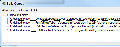

I'm developing a DLL in LabWindows/CVI 2012. After creating a Dynamic Link Library project in Debug configuration, I set the Build»Target Type to Static Library. When I try to build my project after changing the Target Type, LabWindows/CVI throws several link errors:
Undefined symbol'__CompiledDebuggingLevel' referenced in "C:\Program Files\National Instruments\CVI2012\bin\msvc\cvistart.lib".

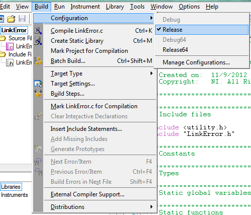

  • Select Build >> Configuration >> Release
  • Release will already be selected but reselect anyway
  • Reselecting Release will create a stable configuration
The link error occurs because the project's Target Type was switched from a Dynamic Link Library in Debug configuration to a Static Library. Static libraries cannot be built in a Debug configuration, so LabWindows/CVI tries to change the configuration to Release. However, this change creates an inconsistent configuration state, which causes the Static Library to build with Debug symbols that it does not define.
