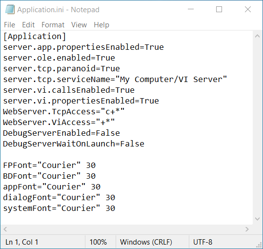

  • I have created a LabVIEW built application (.exe) on a specific version of Windows. When I run my application on different versions of Windows, my font changes style and size. How can I stop this from happening?
  • My LabVIEW front panel contains a lot of labels with different sized fonts. It looks the way I want on my development machine, but when I move it to another computer, the text changes sizes and shifts on the front panel making it unreadable.
  • I want the text to be static on the front panel so when I deploy it to another system it stays the way I specified.

  • Define the font in the initialization file following the steps below:
  1. Build your VI into an executable.
  2. Edit the initialization file associated with your executable to specify the font. Note: the initialization file is in the same folder as the executable, shares the same name as executable, and has the .ini extension.
For example, to set your font to 30 pt Courier in your application, change your initialization file to match the one in the image below:
"Courier" is the font you would like to have and the number (30) after is the size.
  1. Build an installer to install the initialize file and any custom font along with the executable.
  2. Run the installer on another machine with a different version of Windows.
